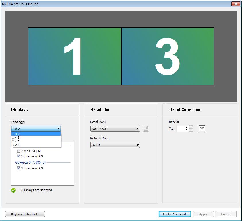

From the Configure Surround panel (figure 3), you'll have the option to choose which displays will be in Surround mode together, as well as the orientation. Make sure to set the orientation dropdown according to how you have your monitors arranged. If you have Y monitors stacked vertically, make sure the drop down is changed to Yx1. If they're arranged horizontally, change it to 1xY. Next, change the virtual arrangement of the monitors to match how they're physically arranged: they should have large, white numbers on them to identify which monitor is where. Click and drag the virtual representation of the monitors in the window to match the order they're in physically. Once you have it set up properly, click Enable Surround.

Figure 2: Configure Surround
Nvidia Set Up Surround
