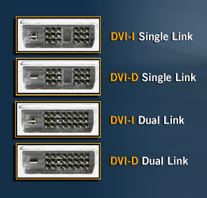

Single Link - 1600 x 1200 Max Digital Resolution
Dual Link - 2048 x 1536 Max Digital Resolution
Notice that Dual Link cables and cards use 6 more pins than are found on the Single Link connectors
But don't take this as the absolute truth - many single link video cards and devices still use the full dual link connector. So it is always best to check with your video card manufacturer to see what type of DVI support your hardware is capable of. |
