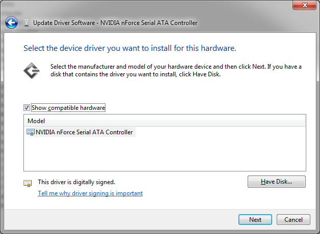

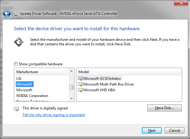

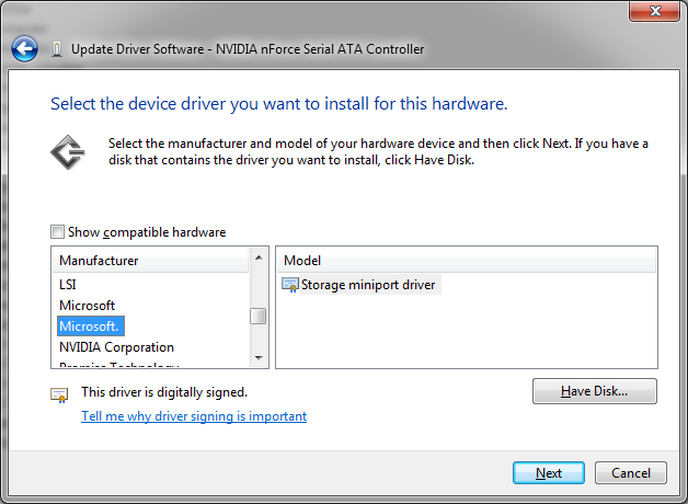

        nVidia mobo's do not have ACHI in the BIOS.....
        If you are using nVidia's Controller, this may not allow TRIM Command to work either, so in order to get things straight, check first to see what controller you have, either Microsofts or nVidia in Device Manager.  If its nVidia's you can switch it to the Microsofts driver by following the below instruction.  I did, and my SSD benchmark went up slightly and TRIM seems to work now.
        How to replace your nVidia Controller to the Microsoft "Standard Dual Channel PCI IDE Controller" which helped in getting better performance benchmark numbers pluse knowing that TRIM is actually activated and working on your eVGA 780i/750i mobo (Perhaps eVGA's 790 as well)with nVidia controllers....
        Step #1... (Device Manager)
        Go into Device Manager by way of Start>typing in the Search Box above Start, "Device Manager" > Click on device manager in the box above when it appears.
        Step #2
        Find and click on Storage Controller where you will find the nVidia installed Controller drivers and right click your mouse button on it.
        Step #3
        Click on “Update Driver”
        Step #4
        Choose and click on “Browse” for drivers
        Step #5
        You will now see two suggestions, one being "Search Automatically" or below that "Browse my computer". Click on “Browse”.
        Step #6
        Next box, you are met with two selections, one being "Browse" and the next one "Let me pick" and that is the one you select.
        Step #7
        Next box pop up, you will see "Standard Dual Channel PCI IDE Controller" from Microsoft and this is the one to click on. You will then be required to restart the system then restart again a few moments later. Now you have the Microsoft Controller and not nVidia, which should give you a better SSD performance.

          Thanks for the Information on this but I couldn't find the Microsoft Driver anywhere?  When I get to Step 7 I only see the Nvidia driver.  No Microsoft driver is available.  If I uncheck the Show compatible hardware check box and select Microsoft I still don't see the driver you listed? My SSD performance seems a little off and I am still worried now that the TRIM may not be functioning correctly :(  I ran some benches on the drive and it was Reading at 240 Mbs and Writing at 170 Mbs.  The specs of the drive say 250Mbs/180Mbs so it's just off by a bit. I just hope it stays this way and that TRIM is working.  Also is there a way to run TRIM manually or does it just get triggered to run when you empty your recycle bin?

            What can I say ?  That is perplexing.
            I found on my 780i mobo in Device Manager, the Controllers were found near the very bottom of the list (Three of them) and this is where the instructions were used to the letter.  Did you by chance not find the 3 nVidia controllers when you click on controllers near the bottom of the device manager list ?
            Go into Device Manager by way of Start > typing in the Search Box above Start, "Device Manager" > Click on device manager in the box above when it appears.
            Step #2
            Find (Near the bottom of the list) and click on Storage Controller where you will find the nVidia installed Controller drivers and right click your mouse button on it.
            Step #3
            Step #4
            Step #5
            Step #6
            Step #7
            After doing this, you will then find that a new entry will be made near the upper third of Device Manager list "IDE ATA/ATAPI Controller" If you click on this you will find the Microsoft drivers listed.

                            So will i ever be able to enable AHCI on my EVGA 750i FTW or do i have to upgrade my PC just to get my OCZ Vertex Limited Edition working at its fullest potential...
                            Does the method above work good? Will my TRIM work natively?
